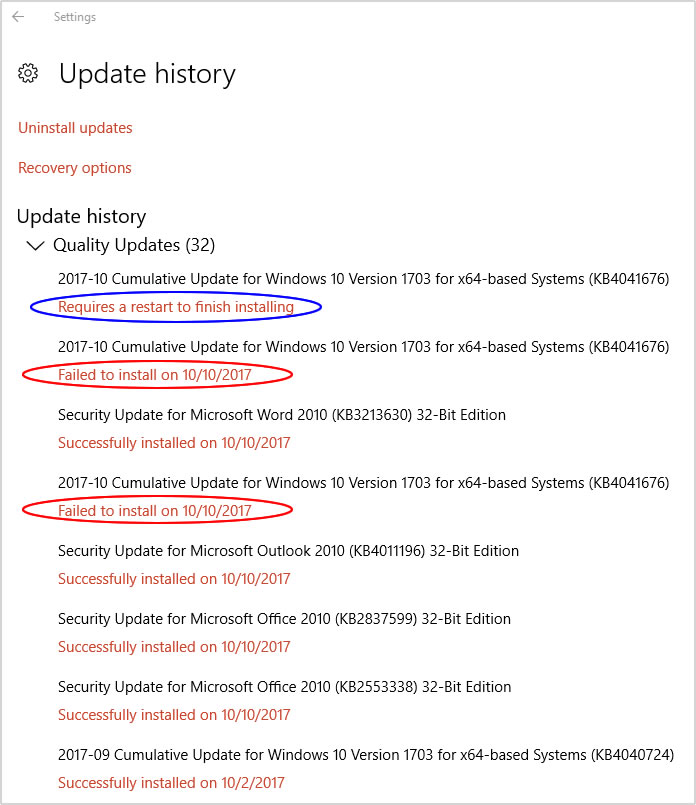

I have this same problem when trying to install Windows 10 update KB4041676. I get the message: "We couldn't install the updates. Undoing changes. Don't turn off your computer." Then, the next time I start my PC, it tries to reinstall and fails again.  See update history below.
When I tried to download it manually and install it manually as suggested by Susan Bradley below...
Go here: https://www.catalog.update.microsoft.com/Search.aspx?q=KB4041676
Download ONLY the cumulative update not the delta for the 64bit platform to a location on your computer.  Click on the file that downloads and see if it manually installs.
... I get the message: "Update KB4041676 is already installed."
Anyone have a fix for this? Thanks.
