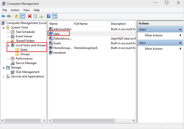

Then press CTRL+R, type lusrmgr.msc and hit enter, to open the "Local User Manager", and click on "Users".

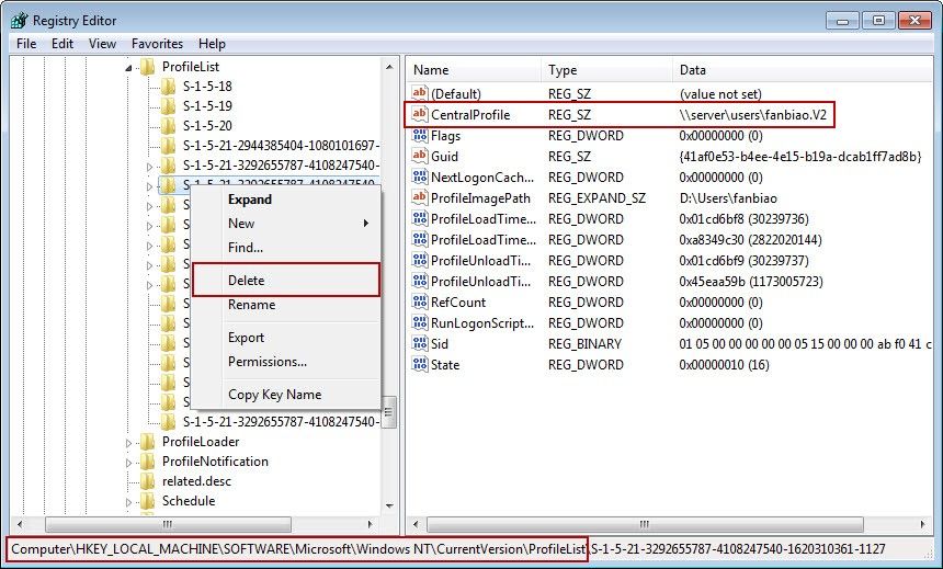

Then press CTRL+R and type regedit to open the Registry Editor.
In this Registry Editor navigate to HKEY_LOCAL_MACHINE\SOFTWARE\Microsoft\WindowsNT\CurrentVersion\ProfileList and it should look like this:
Click on the long profile names (the short ones like "S-1-5-18" are Windows default profiles, do not delete or change them), in the example on the image "S-1-5-21-2668852550-1274502..." for instance, and check the value for "ProfileImagePath" on the right:
The items with short name under "ProfileList" (e.g. "S-1-5-18", "S-1-5-19", "S-1-5-20") are the default Windows profiles, that you also find in the local user manager: "Admin", "DefaultAccount" an "Guest" (and maybe others), do not delete them. You should care only about the items with long names like the one highlighted in the above image!
Compare the value for "Profile Image Path" with the user accounts in your local user manager. In my case what SHOULD be there are "fuerh", "marti" and "paulk". And additionally the default Windows accounts: Administrator, DefaultAccount and Guest.
These three profiles are OK, that's what it would look when everything is fine. There's just "fuerh", "paulk" and "marti" in the list,
But if there are any additional profiles than the three default ones and your accounts that you found in the local user manager, then right click on that key (looks like a folder-icon) on the left, and delete it:
Then reboot your PC and re-try the windows update after the reboot!
There is a guide how to delete a specific orphaned profile called "SID.bak", maybe that helps to explain what I just tried to explain: https://support.microsoft.com/en-us/kb/947242 - it's originally meant for Windows Vista, but I think it still applies.

I was able to create a system restore point but when I proceeded with opening the Local User Manager, this was what I got:
I also tried to go to that Profile List in the Registry Editor but there is no subfolder like that under this path you mentioned: HKEY_LOCAL_MACHINE\SOFTWARE\Microsoft\WindowsNT\CurrentVersion
