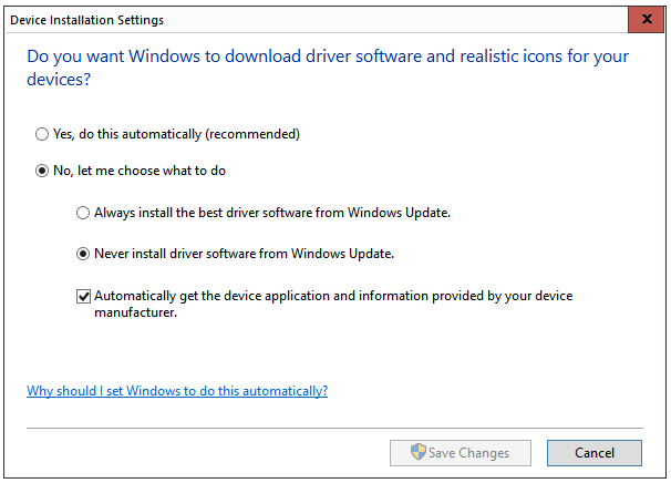

Here's how:
Right click This PC and select Properties then Advanced System Settings in the right hand menu. This will launch a new System Properties window where you need to switch to the Hardware tab. Now select Device Installation Settings and select the following as shown in the image below.....
