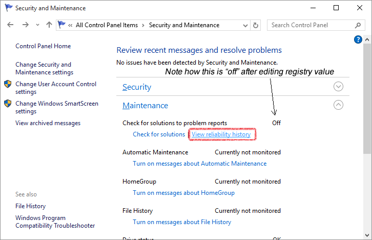

Had the same problem and wanted to disable windows 10 error reporting! Could not find from Microsoft so I searched Google and found answer here " http://superuser.com/questions/950997/disable-error-reporting-in-windows-10-home"
Text I used; (
It appears that the only option available to Home users is to disable Error Reporting via modifying the Disabled key in the registry.
Open Regedit. Navigate to:
HKEY_LOCAL_MACHINE\SOFTWARE\Microsoft\Windows\Windows Error Reporting
Find the value named "Disabled" or add a new DWORD value with this name if it doesn't exist. The default value of this key is 0. Double click it to edit, change the value to 1 and save.
This disables the automatic appearance of the dialogue where Windows is searching online to try to find a solution. You are instead shown a dialogue stating that the application has crashed, giving you the option to Debug. However, unlike previous versions of Windows, no error code is provided in this dialogue. The specifics of the error must be accessed through:
Control Panel\All Control Panel Items\Security and Maintenance
Under the tab "Maintenance", you can click "View reliability history", which will show a list of all app crashes. You can then click "View technical details" beside each crash to get more detailed information, such as a the error code(s) thrown from the application on crash.)

This no longer appears to work as of the anniversary update.  Windows Error Reporting stays on regardless of the presence of the DWORD value.
13 people were helped by this reply
I can confirm Bajax's experience. I too cannot disable the "Check for solutions" (is On since the update to RS1) even though my registry does have the "Disabled" value to 1.
