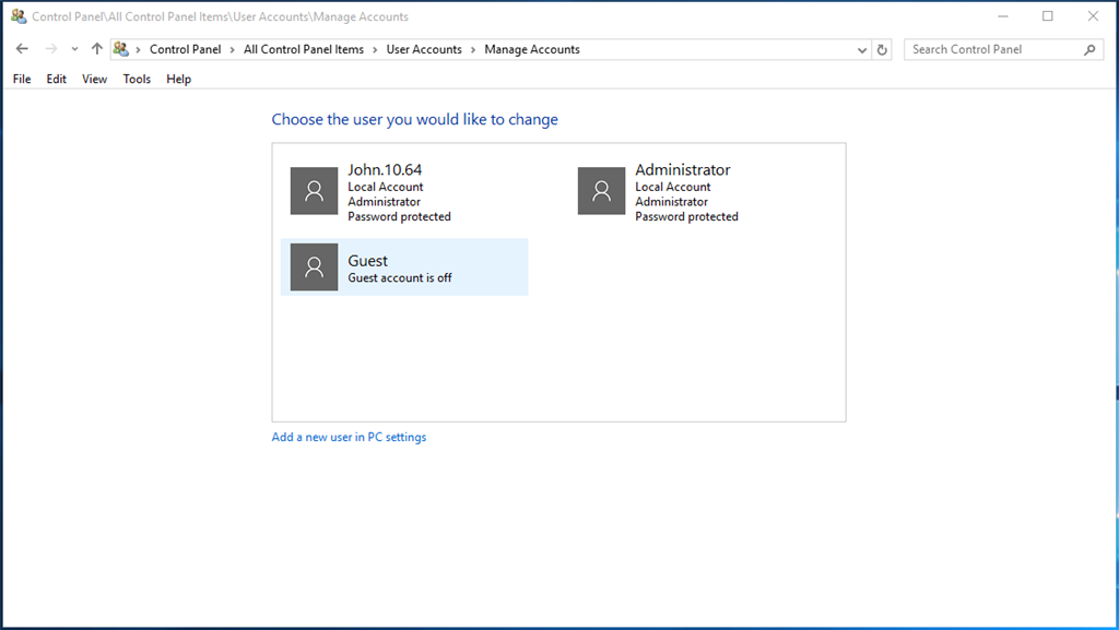

also now Guest account not listed under User Accounts\Manage Accounts . i research this too and found next:

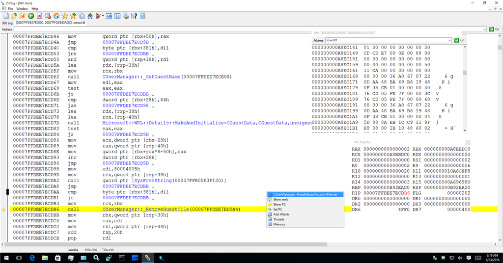

in usercpl.dll was next code

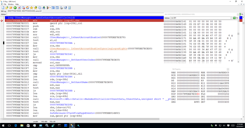

NTSTATUS CUserManager::_HandleGuestAccountTile()
  if (_IsGuestAccountEnabled())
    if (m_bNotShowGuest) _RemoveGuestTile();
  else
and

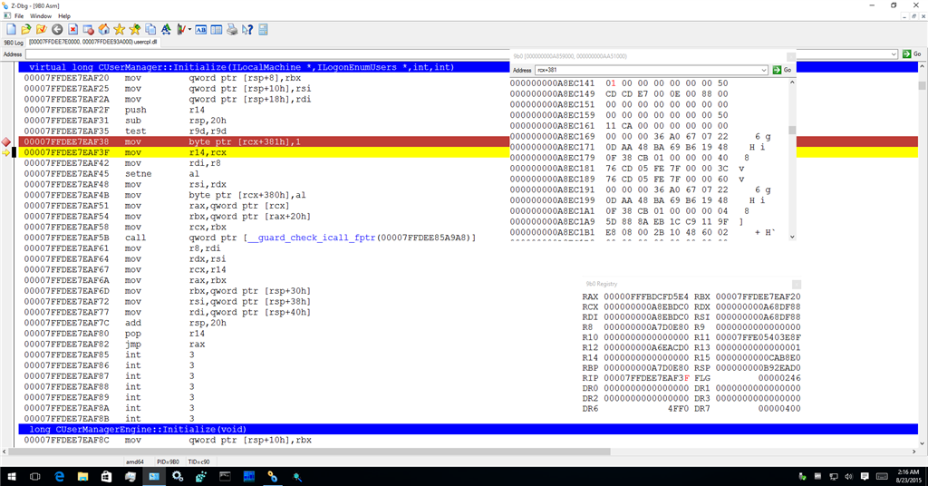

NTSTATUS CUserManager::Initialize(ILocalMachine*, ILogonEnumUsers*, int, int)
  m_bNotShowGuest = true; // this statement is unconditional - always execute
as result _RemoveGuestTile(); always called. if remove m_bNotShowGuest = true; statement - Guest Tile begin shown.

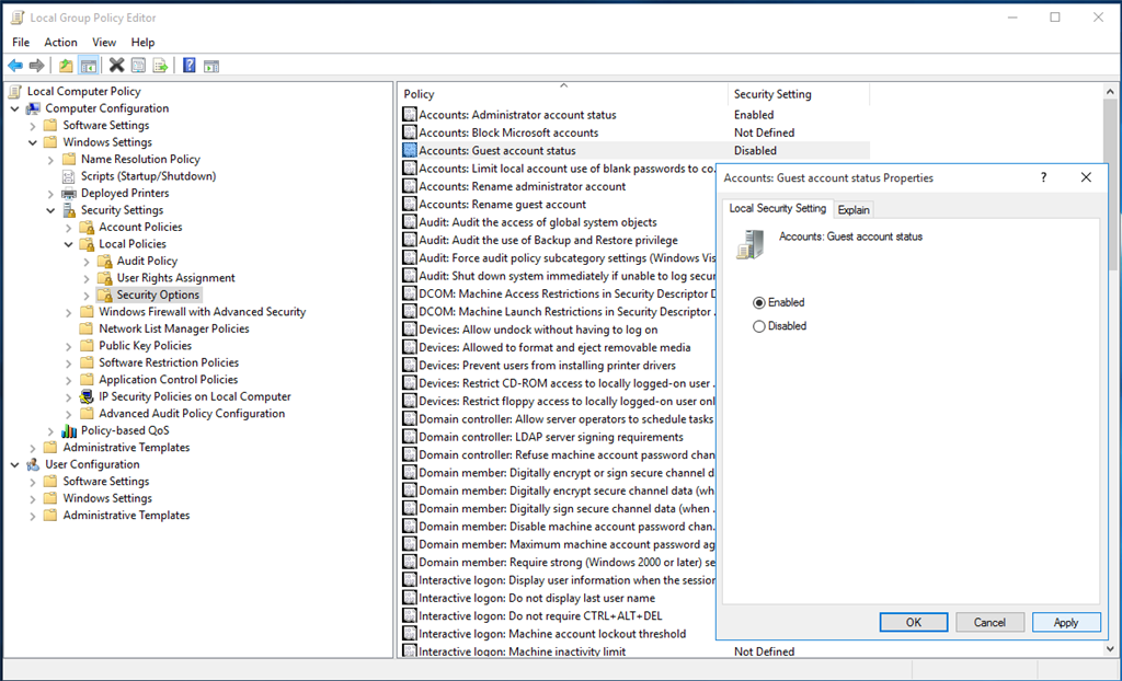

however solution, for enable guest, can be next. you need 2 steps !
1.) first step: (remove UF_ACCOUNTDISABLE flag by calling NetUserSetInfo)
run gpedit.msc
select Computer Configuration > Windows Settings > Security Settings > Local Policies > Security Options
and set Accounts: Guest account status to Enable

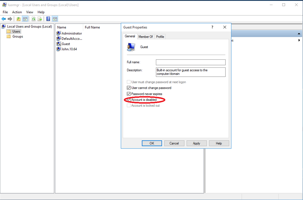

as alternative you can do next:
run lusrmgr.msc and Users > Guest - uncheck "Account is disable"

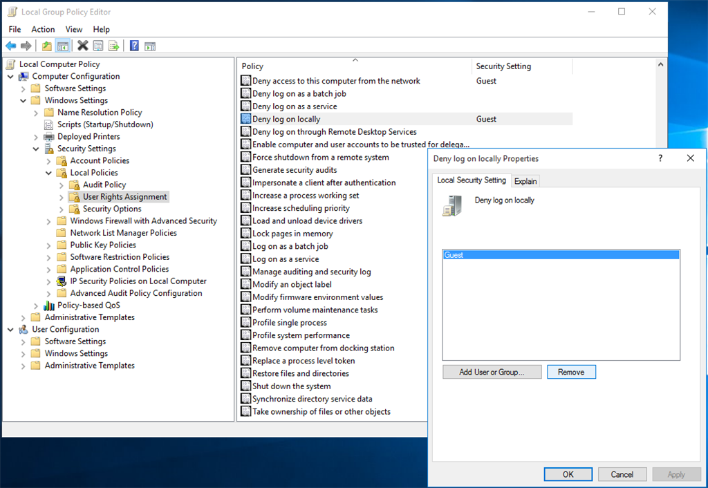

2.) second step: (remove "SeDenyInteractiveLogonRight" by calling LsaRemoveAccountRights )
run gpedit.msc (or it already run from first step)
select Computer Configuration > Windows Settings > Security Settings > Local Policies > User Rights Assignment
and look for "Deny log on locally". if Guest exist here - remove it !
also be shure that under "Allow log on locally" - Guest exist (by default this is true)
(Deny log on locally
This security setting determines which users are prevented from logging on at the computer. This policy setting supersedes the Allow log on locally policy setting if an account is subject to both policies.)

if try Control Panel > All Control Panel Items > User Accounts > Manage Accounts
will be next in windows 10:
first will be called, and here notable line
  m_bNotShowGuest = true; // mov byte ptr [rcx + 381h],1
than called
    return STATUS_SUCCESS;
  if (_IsGuestAccountEnabledIgnoringLogonRights())
    if (_GetGuestUserIndex() <= -1)
      _RemoveGuestTile();
  else
(yes, code is terrible, but this is not mine)
because m_bNotShowGuest set to TRUE in Initialize, _RemoveGuestTile() is called. the name speaks for itself.
run gpedit.msc
