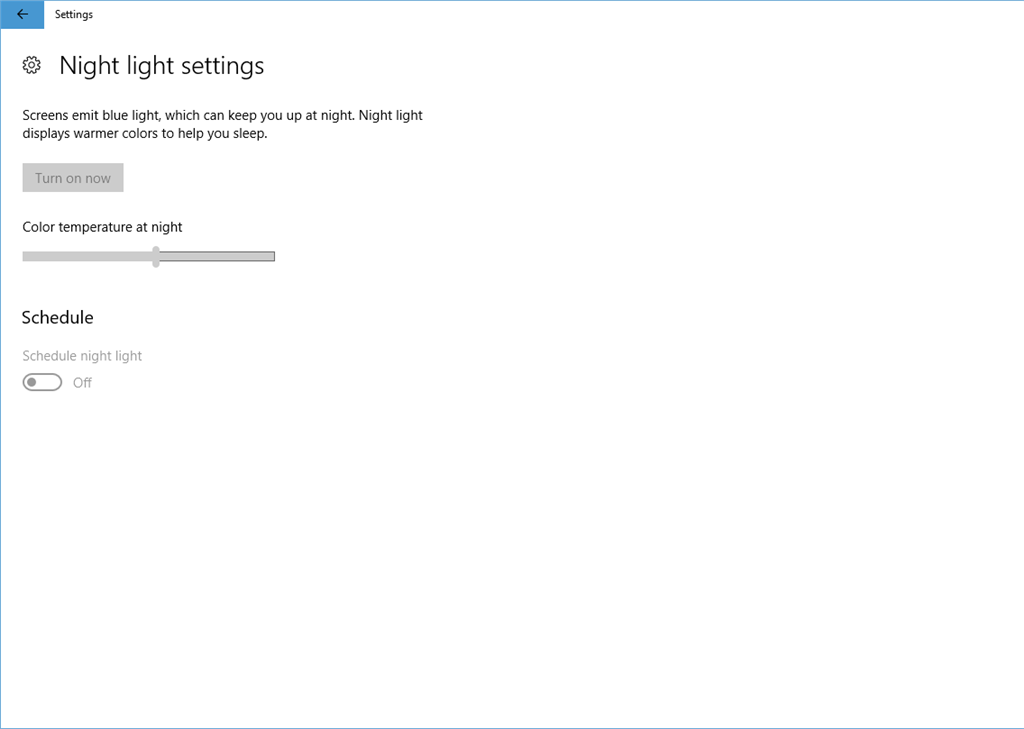

There's a problem with my night light setting, i cant press it on action center neither in the setting. it just unpressable on it. But i can use it right after i installed window Insider's preview, and then i try to use it cause it's night and then i found this. Please help, night light option is really usefull. Tq

My Surface Pro 4 has same issue with Night Light failure as Hairi reported.  The problem started after I turned off the "Schedule" switch...For example = see the Schedule switch as shown in Hairi's top screen print.
I have had the same Night Light failure, as well as other brightness issues, on a Lenovo X1 Carbon since the Creator's Update. My Night Light button in the action panel is greyed out, as is the Night Light control in System Settings.

To address your concern, we suggest you to update the build that your using to our latest build which is build 15061, and check if the experience will be the same.

The NightLight functionality issue resolved when I updated my Surface Pro 4 to the WU build 15058.  (Side-Note:  I can't update to 15061.  Download succeeds but the installation fails.)
This happens when you boot your PC on safe mode (that time one of your service got stooped and yet again when you start in normal mode you couldn't start it the option of turning on the Night mode did not even appear), i had this exact same issue just like them take a look at my pic (option to turn on Night light got disabled completely)
