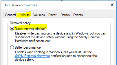

As a general rule, you can simply unplug USB devices without going through the Safely Remove process. "Quick Removal," as shown in Alan Russell's Sep. 12, 2015 post, is the default setting.
But what if you want to be sure your device is set for "Quick removal" and not "Better performance"? On our Windows 10 systems, I didn't see the Policies tab. Well, it is a pretty well hidden. Here are the steps to see it.
1. In Windows Explorer, right-click on the drive and choose Properties.
2. Click: Hardware / USB Device (your drive) / Properties
3. Notice that there is no "Policies" tab. That stumped me for awhile.
"Policies" will appear when you click: Change settings.
3. Click: Policies.  Quick removal is the default. With that setting, you can insert and remove your USB devices quickly!
4.
