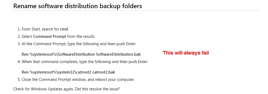

1. Run the Windows Update troubleshooter
2. Rename software distribution backup folders
3. Download the most recent Servicing Stack Update (SSU)
4. Reset or reinstall Windows

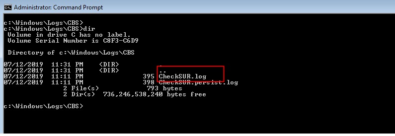

When the SURT is finished navigate to this folder:
c:\windows\logs\cbs
Look for this log file, and open it with a text editor (Wordpad, Notepad, etc.)
