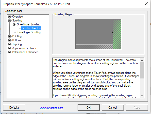

Thank you for the reply. I have already tried that, and pretty much every suggestion on this topic and there are two glaring issues with the Synaptics touchpad since upgrading to Win10;
1. Cannot use the scroll feature
2. The system does not keep track of the on/off state of the touchpad upon reboot
More detail on #1: The system completely ignores the scrolling function even tho the driver in the Device Manager shows that the scroll function is available AND the driver recognizes the area of function, the OS does not recognize the touchpad area, therefore you cannot one finger scroll OR two-finger scroll. This issue alone makes the touchpad unusable.
On the subject of #2: No matter what state my touchpad is in; When you reboot/restart/shutdown the system, the system always starts with the touchpad enabled. It never did this under Windows 7. Ever.
On my computer, you can turn it on or off and I want it off now since issue #1 makes it unusable to me.
I have seen numerous threads with this issue. The hardware AND the driver are recognizing the device and it's ability to scroll - yet, Win10 does not.
