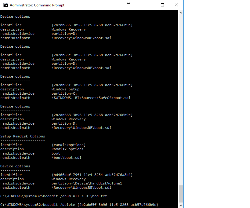

The generic Microsoft answers are not much help, but this is how I fixed the 0xc7700112 error.
FIX - 0xc7700112
Remove orphaned Windows Setup entries from the BCD store.  The error code means setup can't continue because there are traces of an earlier setup installation attempt within the Boot Configuration Data file.
From an administrative command prompt (cmd > right click "Run as administrator") type this
bcdedit /enum all
You will probably see multiple sections like this:
You can pipe the output to a text file for easy reference and copy / pasting.
bcdedit /enum all > D:\bcd.txt
The Device Options sections with the description Windows Setup are left over from earlier attempts and are blocking the current installation.
If you delete these entries then the W10 in-place upgrade should be able to complete successfully.
Copy the identifier in the {} brackets for each of the Windows Setup sections and append it to the delete command like this:
bcdedit /delete {your-identifier}
e.g.
bcdedit /delete {cbd971bf-b7b8-4885-951a-fa03044f5d71}
Repeat as necessary for each Windows Setup entry under Device options,  you don't have to worry about the excess Windows Recovery entries.
Reboot and check bcdedit /enum all again to make sure they have gone, and then you can run W10 Upgrade Assistant without problem.
