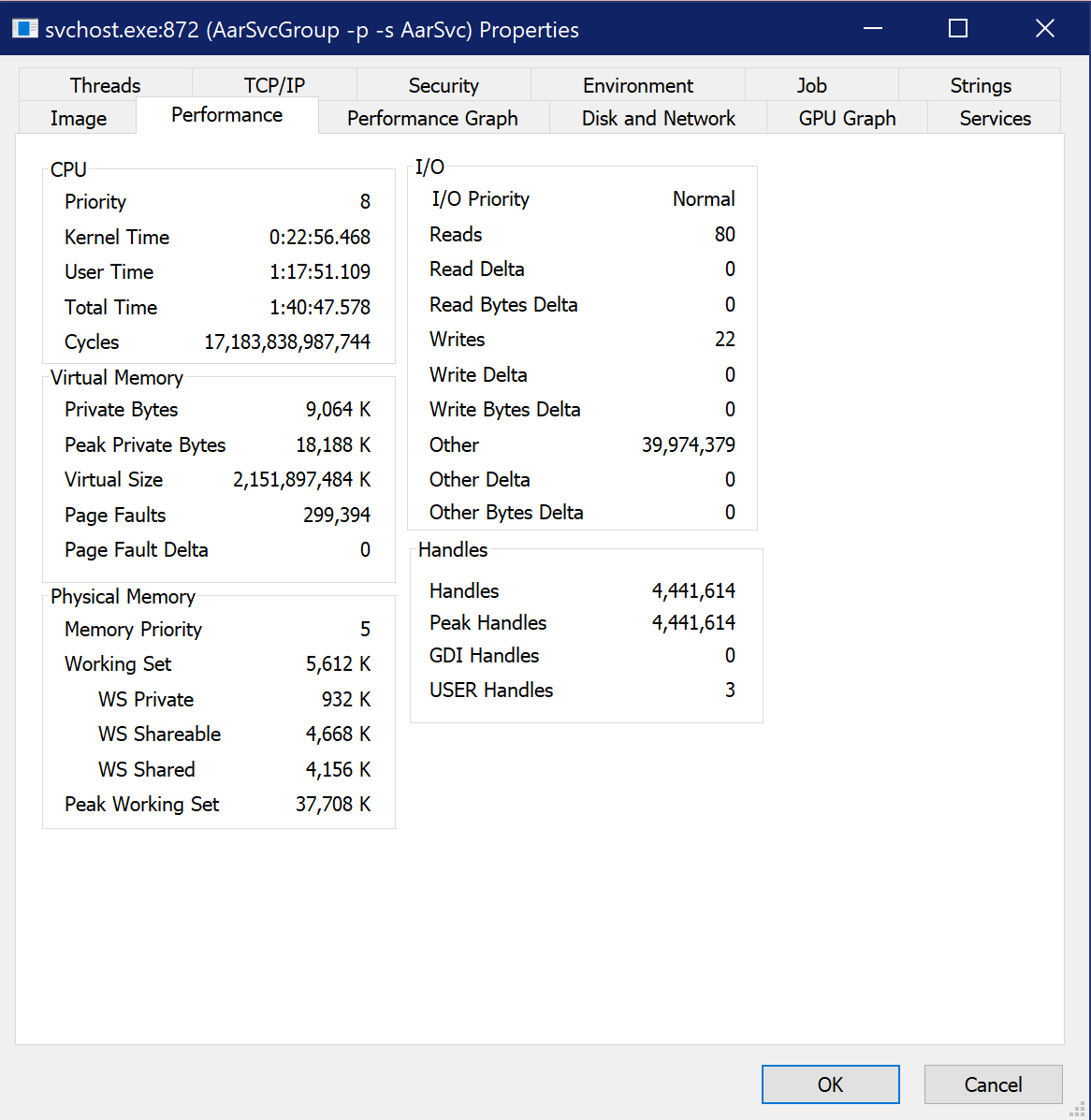

P.S. Might've discovered a svchost(Agent Activation Runtime) handle leak on my way to testing...😅Right now it seems to be stable at ~4 million handles, with no obvious influence on the system...
