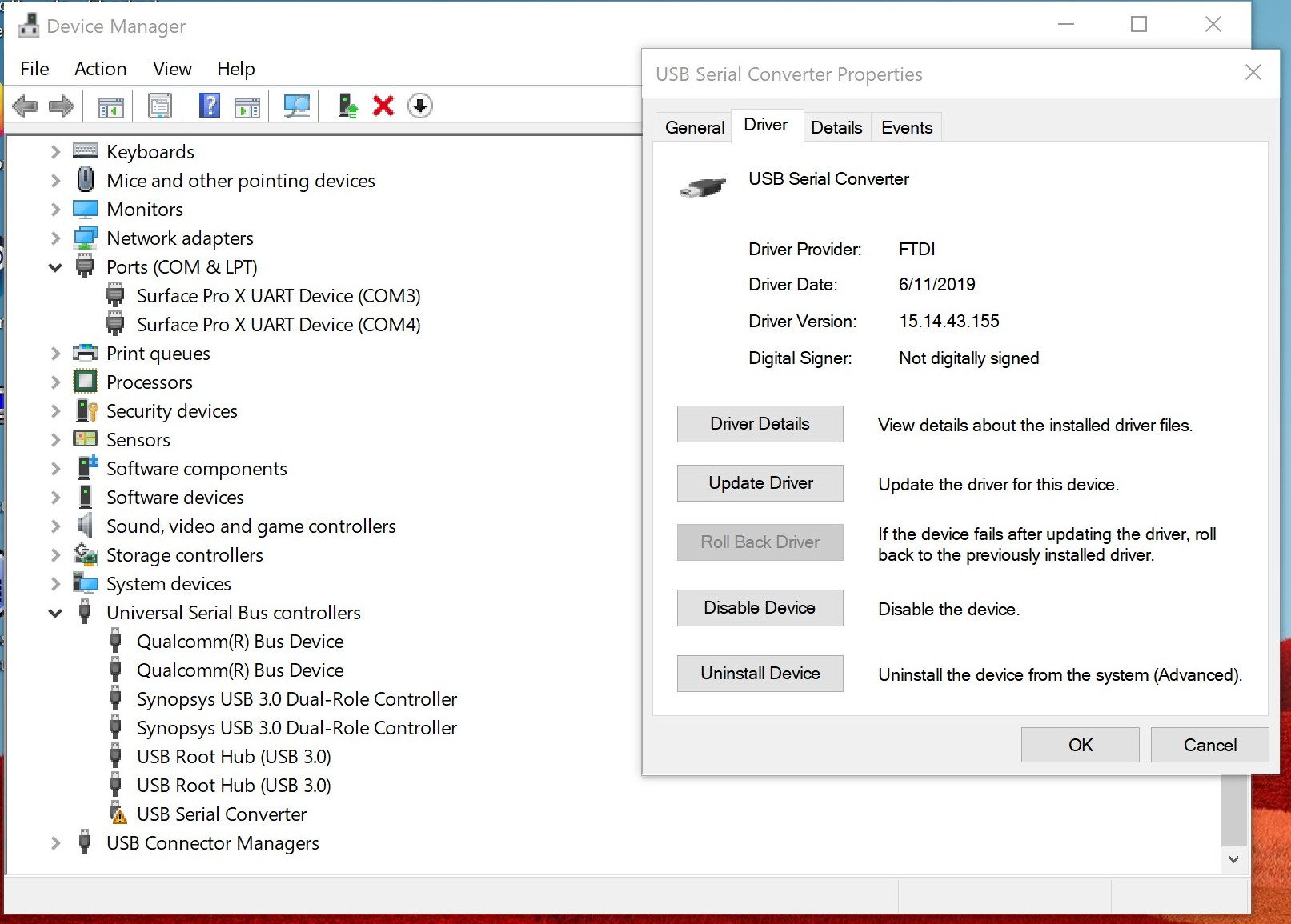

Hey all.
Yes and no. I got the driver to install, but for some reason I can't seem to use it. I'm not sure what COM it should be, but I never see another one show up other than the Pro X UART devices that were already installed and listed as COM3 and COM4. I was expecting to see a COM1 or COM2 be listed under Ports but it isn't:

I did have to disable the digital signature verification, and it's rather annoying to do that in windows 10 (which does not persist on a normal reboot), and that's compounded by the fact that these machines have bit locker enabled too.
Maybe I've done something wrong, not sure. I was trying to test this using an ARM64 build of Putty that I got from someone on XDA Developers and was trying to open the terminal of a network switch which in theory should work. What app are you guys using?
Maybe one of you will have better luck than I have so far.
