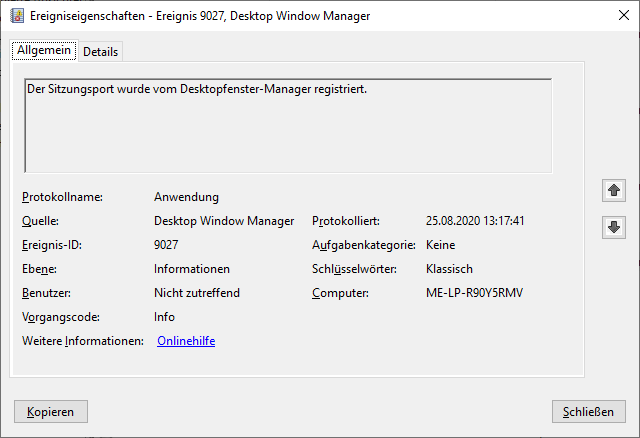

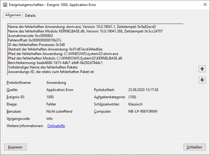

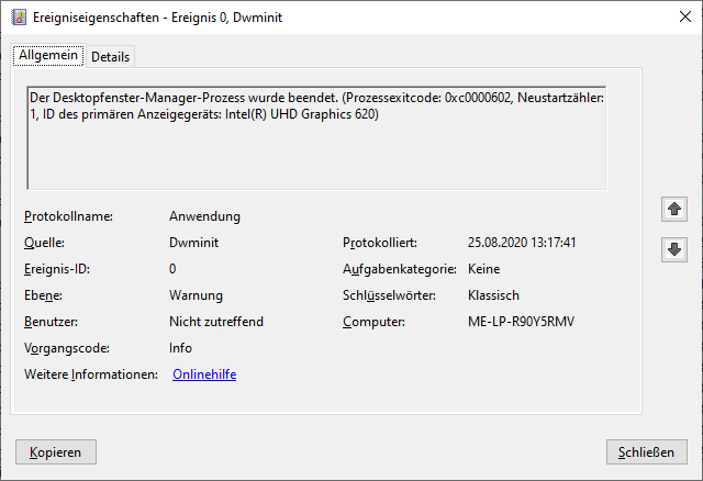

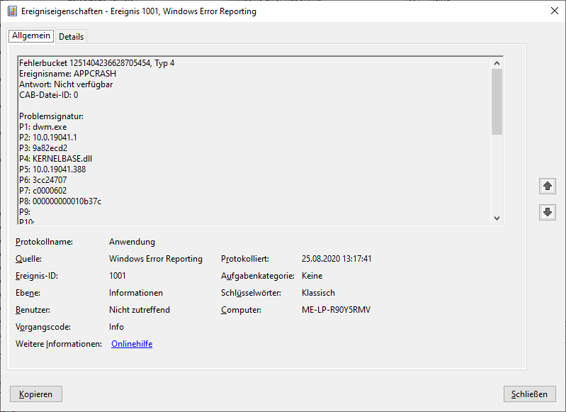

Additional Information:
I have here the error Messages from the Event Log. Unfortunately they are in German. Maybe someone else with the same problem who runs an English OS can upload them in English. In the meantime I added some translation below each picture.
Overview of the 4 Entries that repeat over and over again for each time you try to write:
From top down it says: "Information", "Warning", "Information", "Error"
It says: "Name of the Application that caused an error: dwm.exe" and "Name of the Module that caused an error: KERNALBASE.dll"
It says: "Event name: APPCRASH" and on the next line "Answer: Not available"
It says: "The Desktop Window Manager Process was stopped (Process exitcode: 0xc0000602, Restartcounter: 1, ID of the primary Display Device: Inter(r) UHD Graphics 620)" (Comment: As stated above these 4 Entries repeat if you continue trying to write, this is just the first 4 entries after a restart, the counter increases every time of course.
It says: "The Session report was registered by the Desktop Window Manager."
