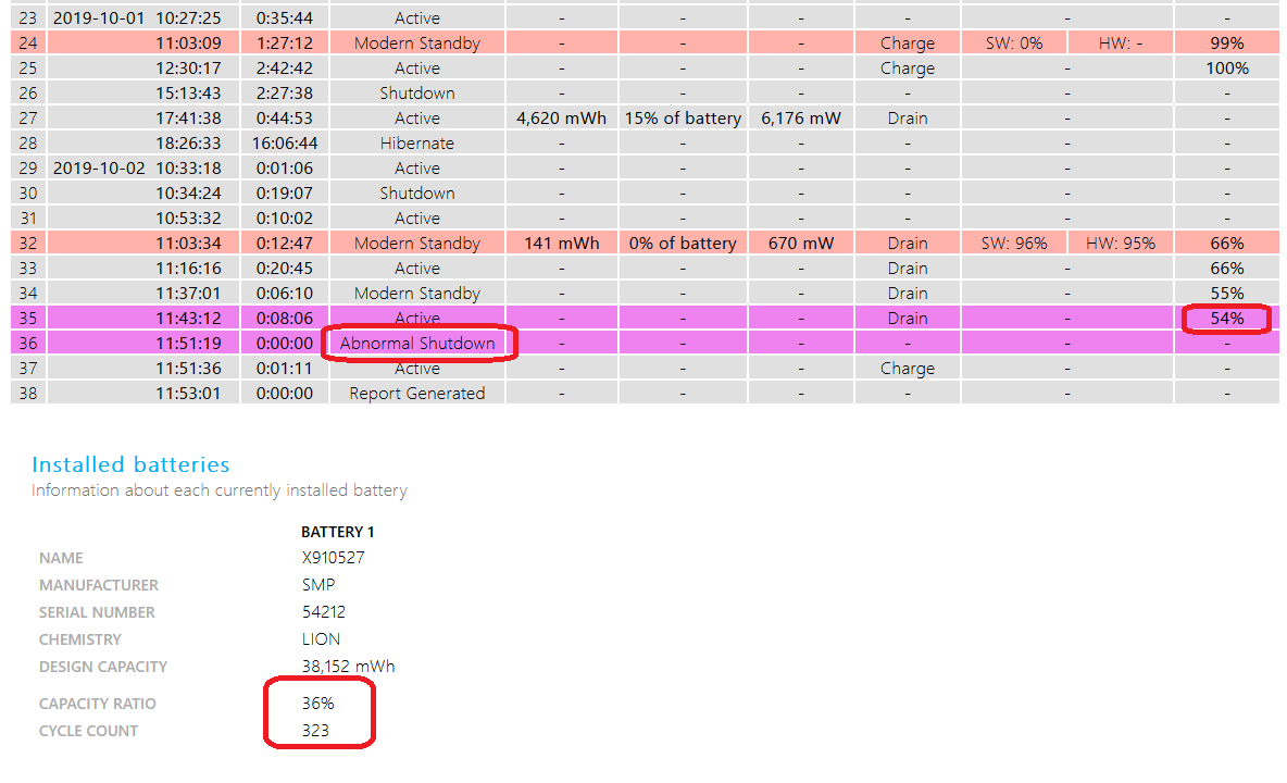

Following the t'shooting steps on Microsoft's website about Surface Pro Batteries "Uninstall and reinstall the Battery Driver in Windows" (https://support.microsoft.com/en-us/help/4484738/troubleshooting-surface-battery-issues), I deinstalled then reinstalled the Battery driver.
At first, I thought that these steps solved my problem, as I could work a little less than 1.5 hours while the battery drained apparently steadily but very gently to about 54%, then...BOOOM ! black screen...brutal and dirty shutdown !
This is much worse than a few days ago (where the unexpected abnormal shutdown occurred when the battery meter was around 20%) !!!
Also the apparent available capacity has dramatically decreased in just a few days.
I guess this means my battery is plain dead. (but strangely the problems became very severe right after the latest update...)
With only 323 charge cycles, I reckon this absolutely unacceptable.
I have to dump a perfectly viable €1,500 machine because the non-replaceable battery is so poor quality ? (no value for reselling in 2nd hand)
By reading other posts, I doubt a refurbished machine will do much better, so I'm not keen to pay nearly €500 for a out-of-warranty "repair".
