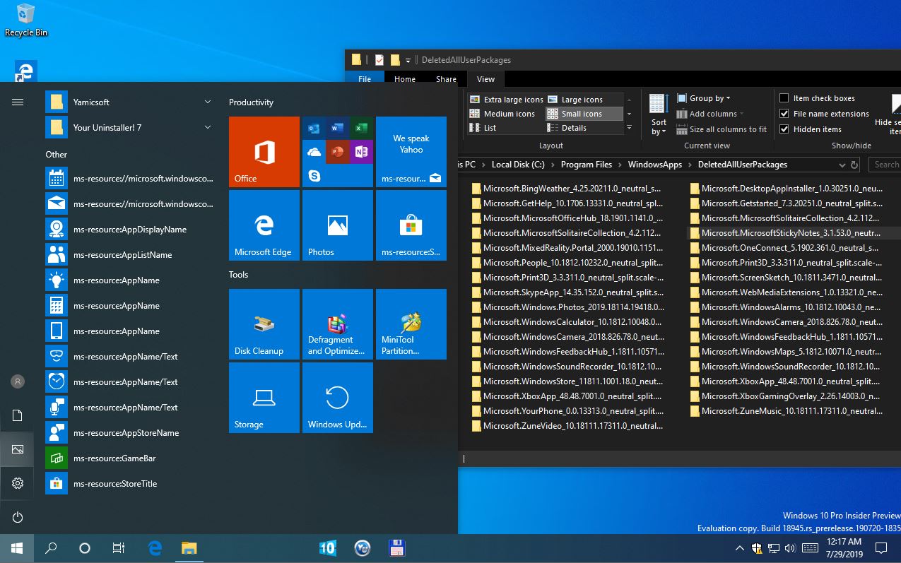

Here's another pic of 18945 showing the result of upgrade from 18362. Apps were moved to "WindowsApps\DeletedAllUserPackages" without any replacements to the WindowsApps folder which is where I believe the issue lies.

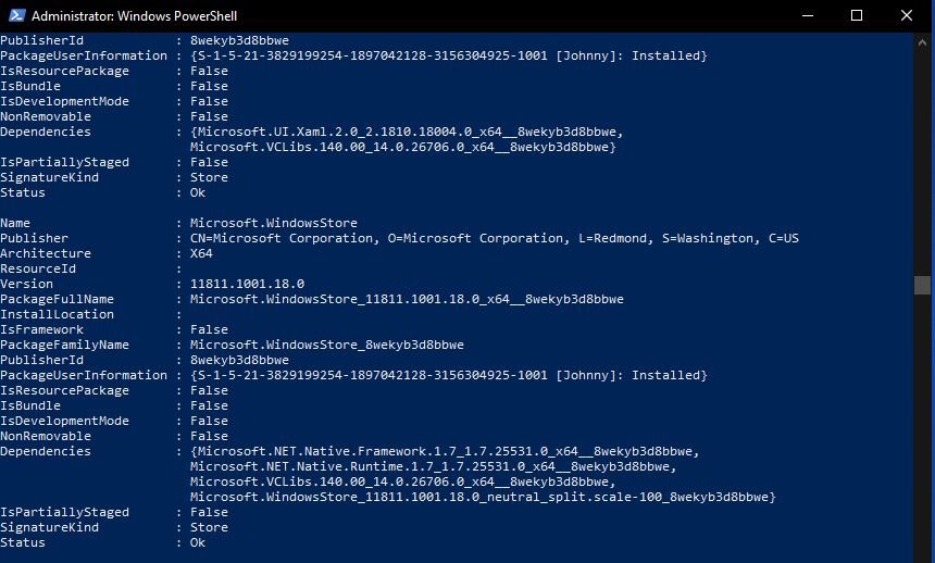

Then I copied "Microsoft.WindowsStore_11811.1001.18.0_neutral_split.scale-125_8wekyb3d8bbwe" over to the WindowsApps folder. Ran "Get-Appxpackage –Allusers"
Then I ran:
Add-AppxPackage -register “C:\Program Files\WindowsApps\Microsoft.WindowsStore_11811.1001.18.0_x64__8wekyb3d8bbwe” –DisableDevelopmentMode
No go. Next up was the command to install all apps:
Get-AppxPackage -AllUsers| Foreach {Add-AppxPackage -DisableDevelopmentMode -Register “$($_.InstallLocation)\AppXManifest.xml”}
No go with this either. Same as running the script you posted. Now this is getting even weirder.

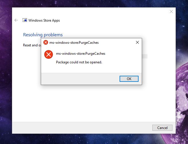

Ran "Appsdiagnostic10.diagcab". It wanted to turn UAC back on and made me sign in with MS account. Did that, my wallpaper synced up, everything seemed normal. Result:

wow! that's pretty weird in deed, never seen that error before.
I'm out of ideas except have you ran a virus/malware scan just in case. Good luck!

I think your second command should have worked, but the first could have been (you didn't specify the Appxmanifest.xml):
Add-AppxPackage -Path "C:\Program Files\WindowsApps\Microsoft.WindowsStore_11811.1001.18.0_x64__8wekyb3d8bbwe\Appxmanifest.xml" -Register -DisableDevelopmentMode -ForceApplicationShutdown -Verbose
I usually add the -ForceApplicationShutdown in case anything is running that could prevent install.
The command would only work if all of the app files were in the specified folder and even then, I don't know if it would actually reinstall Store if Store is missing. My example below is from my 19H2, so slightly different version.

This is the contents of my WindowsApps Folder going back to snapshot of just installing 18945. There be many missing files.
I then copied over "Microsoft.WindowsStore_11811.1001.18.0_neutral_split.scale-125_8wekyb3d8bbwe" from the DeletedAllUserPackages Folder and ran:
For comparison, these are all the files copied from working 18945 to the broken one that worked as soon as the copy completed. Quite a few missing files compared to the first pic. These of course were all updated so different version #'s.
