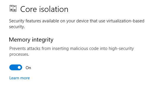

I've never seen this before. I always enable this feature in every build without a problem but fails to start on 18922.
Memory diagnostics OK. Anyone else seeing this? please upvote https://aka.ms/AA5djme

I don't think virtualization has to be ON for this to work but YES to both questions.
Remember I said that I had this feature enabled and working on previous builds.
Memory Integrity can be turned on with no problems in Windows Security/Device Security/Core Isolation.

Never had a problem with this feature before. I tried uninstalling those files by clicking the buttons, they disappear and when I try to enable memory integrity the error pops up and those files show up again.
I was able to fix it by taking ownership of those files and deleting them. I don't know, some drivers from DevGuru Co. LTD but I don't have any of their software installed.
Credit and thanks to GitHub member RAJU2529 for the tip.
