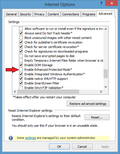

step 1: I have go to the 64 bit program files internet explorer folder and when I run the iexplorer.exe, it is still run 32 bit not 64 bit version.

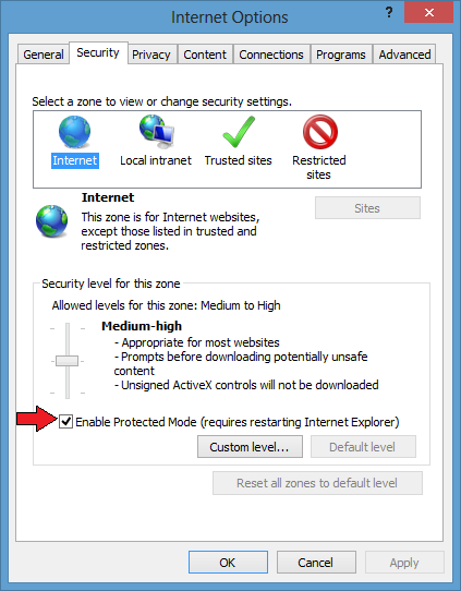

step 2: I have checked the security tab in the internet options and where I am supposed to find a check box for Enable 64-bit internet explorer, but the check box does not appear.
I am running windows 8 64 bit, I want to run internet explorer 64 bit, but all the references I have read are all inconclusive, because, in both locations of the c:\program files (x86) and c:\program files where I am supposed to find 32 bit version and 64 bit version both run 32 bit version of internet explorer 10.

1. To select the 64-bit browser mode................Open Internet Options.
2. Click on the Advanced tab, scroll down to the Security section. Turn on "Enable Enhanced Protected Mode" and you have enabled the 64-bit browser in IE10, Windows 8.
 3. Then...open the Security tab .
If not already checked, select the "Enable Protected Mode" box for the Internet zone. (this box is usually checked by default).
Click APPLY.... OK. to set the IE10 64-bit browser for the Security Zone..
4 To set the 32-bit browser for the security zone, simply UNCHECK  "Enable Enhanced Protected Mode" in Step 2.
Click APPLY..  OK.
5. Restart the computer when you change the browser mode.
Once you have chosen your preferred settings for all the security zones, simply restart Internet Explorer. You will now be able to browse the zones in the corresponding 32-bit or 64-bit modes. This new method seems to be a welcome change considering it removes the necessity of having two versions of the same browser installed while still granting access to both versions.
